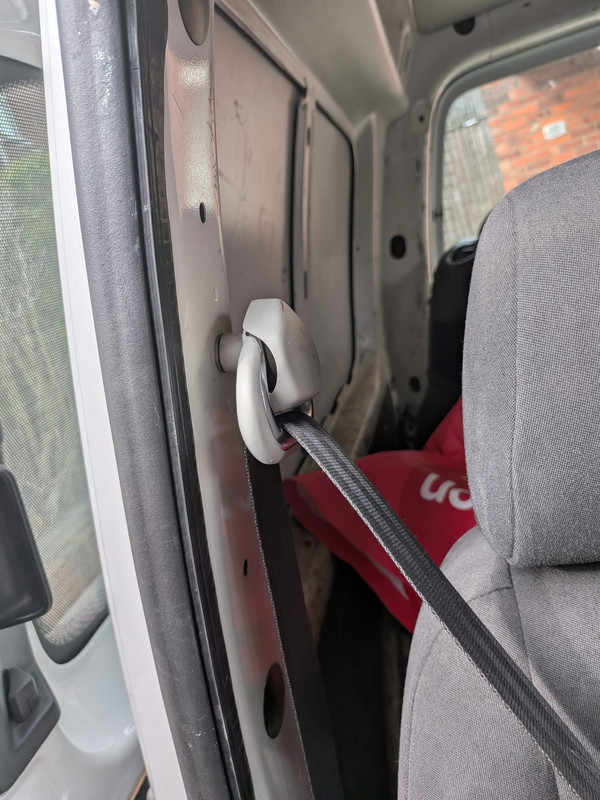

have you seen how a factory 5 seater looks?
I can take photos if it helps as mine is factory 5 seats.

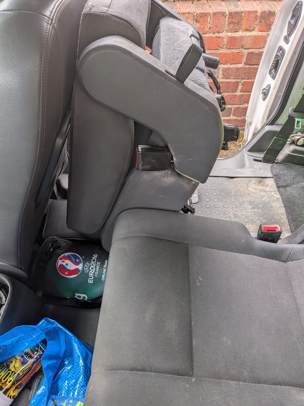

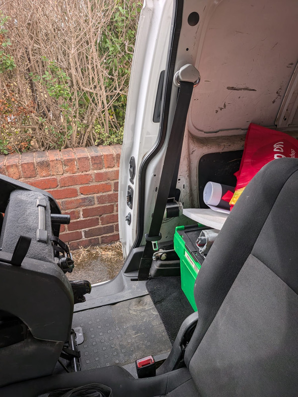

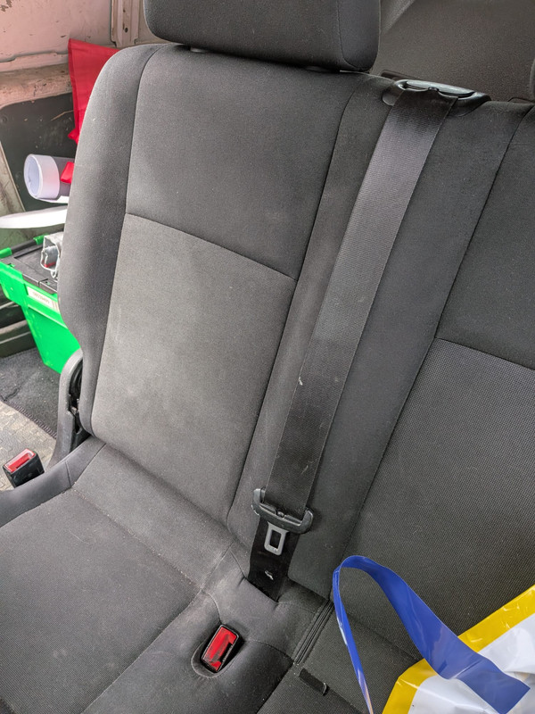

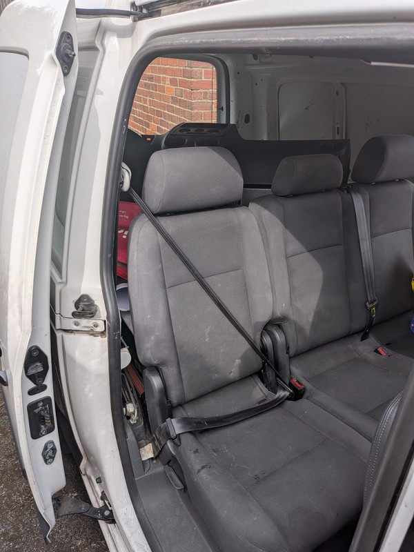

Re: Rear seat conversion
OK, hopefully the pics speak for themselves...
check to see if the hole in the c pillar is already tapped as that'll save some messing about. you'll have to drag the panels off in the floor to check the bottom mount
