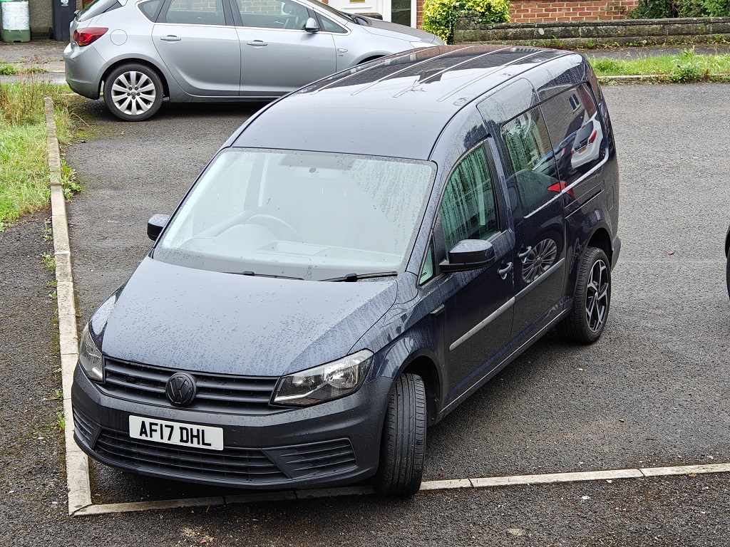

Removed the roof rails.
Now it desperately needs lowering!
