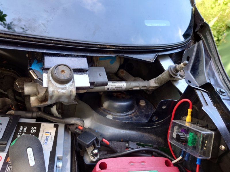

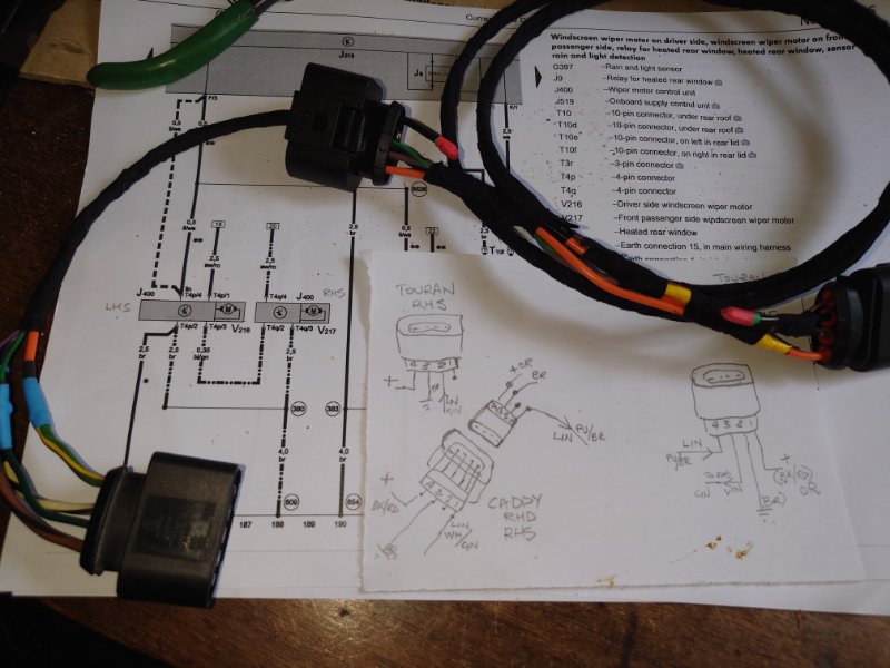

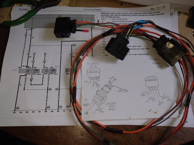

Posts: 2310
First fit ...
LHS Wiper Motor (Touran)
Posts: 2310
And ...

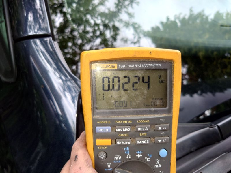

Finished the adapter cable now the second plug turned up.
Tested with both motors connected and all seems good so far !
Clamp meter shows only 22.4mv on 10mv/A range (if I am reading things correctly !?
No load as the wiper arms are slowly travelling around Europe
DE to Latvia, then UPS back to DE, and hopefully arriving here tomorrow.

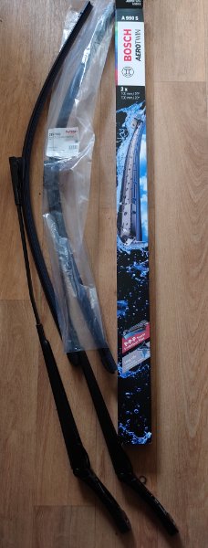

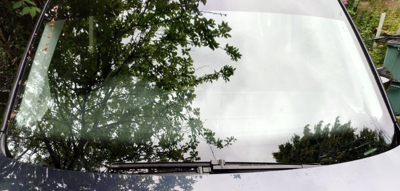

Posts: 2310
Wiper arms arrived 👍
Fitted the Bosch blades.
Raining today so final fit tomorrow ...
Gives the Sikaflex a chance to cure a bit more :shock:

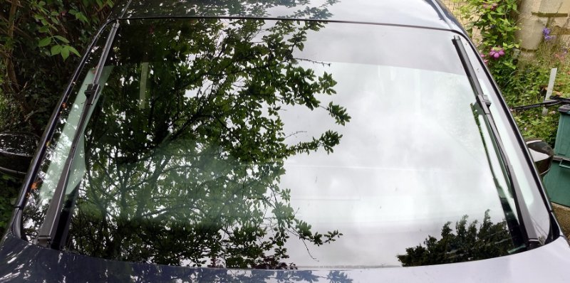

Posts: 2310
Finished

petrev wrote: Thu May 23, 2024 7:30 pm Finished
Looks good! Any chance of a video?
Posts: 2310
Video of them working ?
Yes (possible)
How I did it ?
Too late 🙂
