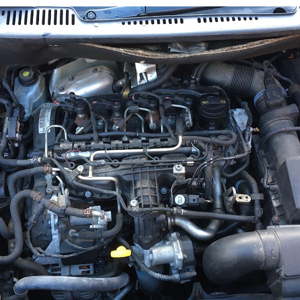

suzierobs
Posts: 21
Joined: Fri Aug 06, 2021 5:51 pm
Re: Ravenna Blue Caddy
Post by suzierobs »
Looks great 👍
When you fitted the engine cover, did you need any fixings, or did it just clip straight on?
I’ve got the same engine (I think), here’s a pic - would I need to get fixings or just the cover?
Thanks in advance for your advice 😊
Engine bay
Engine bay
J_Con
Posts: 607
Post by J_Con »
@suzierobs thanks!
The oil ring isn't needed to make the cover fit but stops spilt oil so worth doing imo, part number is 03L133287, and you'll also need 2 Mounting Ball heads, part number is 03L103164

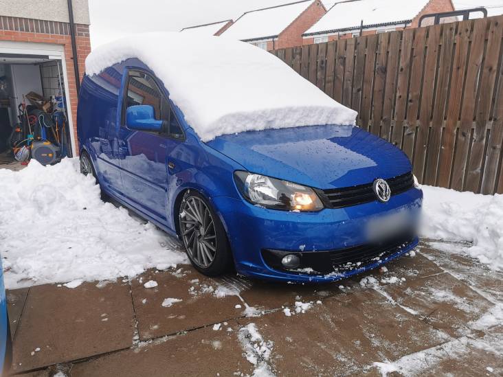

J_Con
Posts: 607
Post by J_Con »
Bad snow last year and soon as I took the van off the drive the coilover had snapped, can see how much lower the front is
