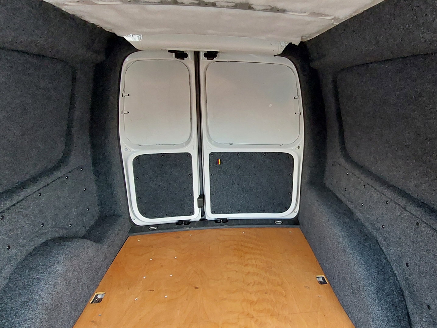

So, on to one of the main jobs that everyone has to do - and I don't think it's anywhere near as much fun as it looks when you watch some else do it on YT! the carpeting
If you're reading through this before doing a van for the first time - DO IT SLOWLY! - It will take longer than you think
, If I remember right I went with Anthracite colour because I felt that full black colour would probably show up dirt etc a lot more.
Taped up all the holes with 2 layers of foil tape
Removed the bulkhead and taped some plastic dust sheet up to stop the glue overspray from getting into the front
Getting stuck in, a reet mess!
These little clamps from BQ were super useful to hold the big pieces in place and not get stuck to itself

Eventually getting through it, You can see a few wrinkles on the wheel arch, these will be covered up by the box though. I made the mistake of sticking the carpet into the recessed parts first which isn't the best way, it's better to hang the carpet and then stick down all the large/main parts and then use the stretch to work it into the small or tight parts....
Finally done, had to work out a few random wrinkles and make a cut in the corner of the barn door pillar/wheelarch section but happy with that in the end.

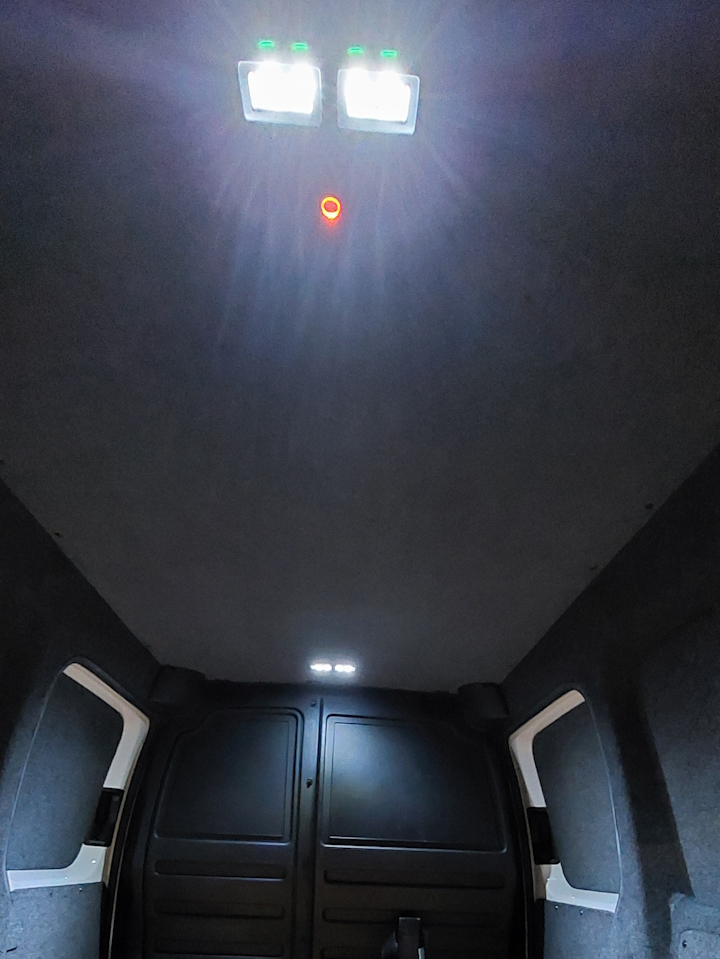

After a test fit, it got carpeted and the lights put in. I made a perfect wiring harness for the lights, nicely taped and with superseal connectors but found that it wouldn't pass through the gap behind the roof ribs so I had to cut the connectors off and use single bullet connectors for each wire, somewhere along the way I've connected them wrong and the lights don't switch to the permanent feed - after the faff to put the roof in, I'll have to wait until I'm in the right mood before taking that out again lol! Looks ok though, 2x Golf R interior lights and it's super bright inside.
